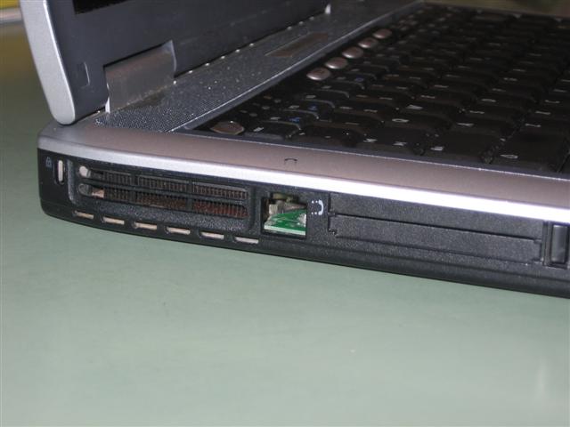

On the bar is my neice's laptop 2300, the modem jack is gone. Someone tried to help out by seeing if they could fix it. We need a new jack for the unit wihch is 2 years old. Apparently the modem is a card inside, and the jack simply mini-pins to the jack with two tiny wires.
I may could have fixed it for her if it were available. Her helper tossed it since it was disconnected. Oh boy.
Here is what we need, a place to get a jack. Anyone know where to start or a place to go? She called Compaq and the person who barely spoke English told her she didn't know of a part by the name modem jack. Grin. Only in America.
TIA What do now?

Yes, it's built in, not external. The jack location where the phone line hooks is now a rather square hole and you can look in and see motherboard or modem board. I know there has to be a part for this baby. On Ebay we see parted out Laptops of every variety, just no Compaq Presario 2100 laptops, there is one out of a 1900 and it looks like a phone jack with two tiny wires to a twin microplug that you see in electronic stuff.
Her four year old stepped on the cord and yanked the jack, which lost connection. Apparently we need a new jack, the other is history and missing.

Bruce it is usually an RJ11 Connector, any electrical component wholesaler will carry them, usually you just buy the whole lead, or is it the socket thats gone ?
Do you have Radio Shack or Maplins in the US they would have them.

I'd probably just get a new pcmcia modem that fits in the card slot. They go on eBay for pretty cheap, or about $30 for new.

We couldn't get the back off, but we did get a nice look inside. There are no visible pins. Wish I'd been there when it was taken apart and could see the way it was.

Yeah, that just looks pretty much broken; standard RJ11 phone plug, though. PCMCIA modem's your best bet. Good luck!

Hey Bruce, I work for Compaq (well, now we are HP). I doubt you'll have much lick finding a replacement part for that. Mattia's suggestion of a PCMCIA modem is the way I would go. I can't even tell from the pic whether any of the case got broken or not. If it did the new part would probably just dangle from the wires anyway.
Good luck with it.

Thanks Everyone. This is so cool. My neice, surfed on over to Ebay, and looked through a million auctions. She found six nex xircom 56K Modems without the dongles for ten bucks. I told her that one without the dongle she was out of luck.
She found what she needed, a used Xircom 56K Modem with Dongle for $2. plus $5 shipping, after asking the guy to change it to a Buy IT Now, he did. It's on the way, and she'll be back in business, thanks to all of you. She knew how to do this, I did not. So you guys talked me through it, mucho thanks. I've never owned a laptop.
Once again, life is good. Very good.
